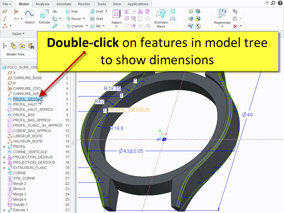

Double-click on features in model tree to show dimensions
Make double-click action possible on features in model tree to show dimensions.
Features are not always visible for double-clicking modification in graphic environment (hidden curves for example).
Right mouse button action is not as straight forward as double-clicking.

In fact, there are many features that do not work
NicolasBourgeoi1
« unless the Hide feature has been applied to that feature » or is hidden in a layer.

well, double click in Model Tree is reserved for collapse / expand action ... making system "over smart" to behave differentely for non-expaqndable nodes would make no real good imo.
Patterns can have dimensions and can expand. Sane components etc - so if you add Show Dims action you get clear ambiguity.

Hello Vladimir,
You can expand or collapse the group with a simple click on the arrow beside the collapsed function.
Double clicking is then redundant.
Double clicking on a sketch or any dimensioned feature would be useful to show dimensions.

If you are intending to quickly enter "Edit-Dimensions", then this is accessible much faster in the more recent Creo versions as it is the first action in the mini toolbar. That workflow is nearly as fast as a double-click and doesn't interfere with current double-click actions.
Can you re-confirm in a more recent Creo version?
