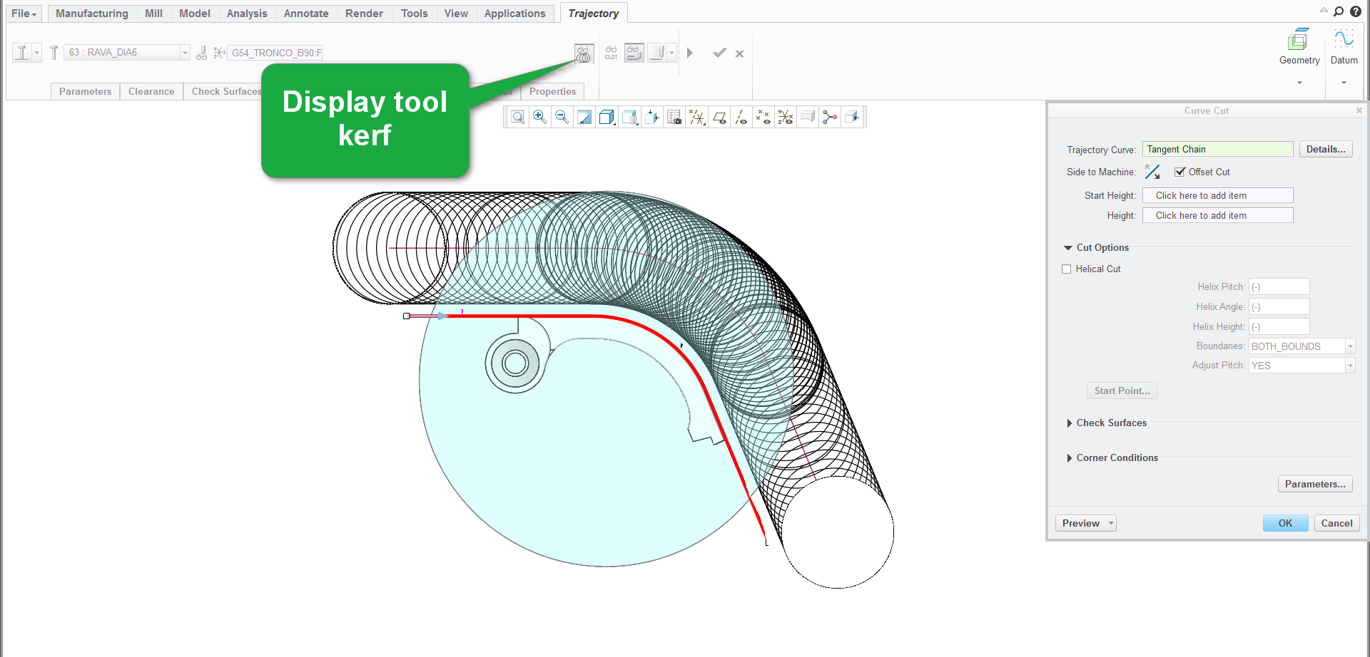

Currently, if you want to see the milling area, it's necessary to play path trajectory, display tool kerf, analyze toolpath and go back  to edit definition mode.
Idea: Add possibility to display "Tool Kerf" (trace of tool along toolpath) in Edit Definition Mode of Pro/NC sequences without playing toolpath.
