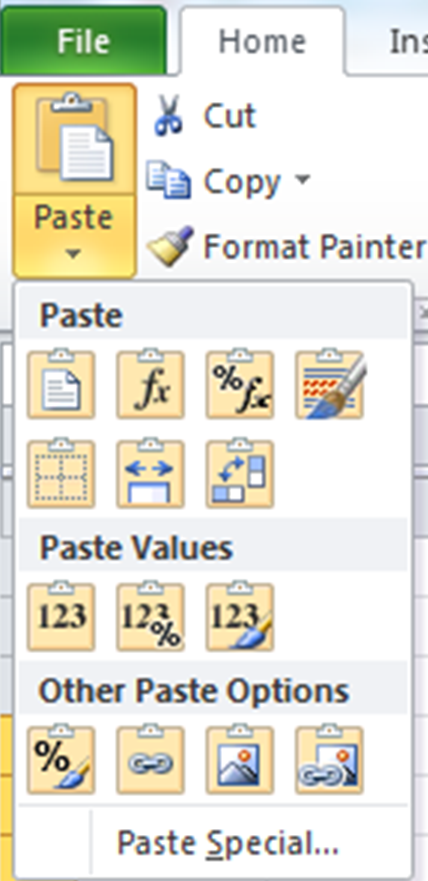

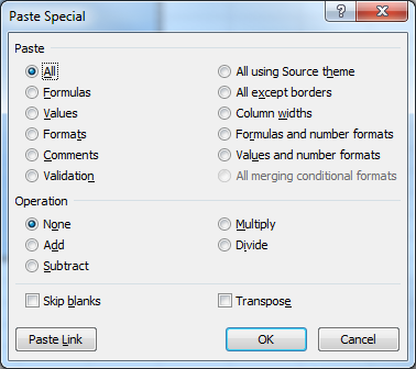

I am reminded of those paste icons from excel.  Excel does this but is 5x worse!
I always give up and just use the paste special which just lists them with text
