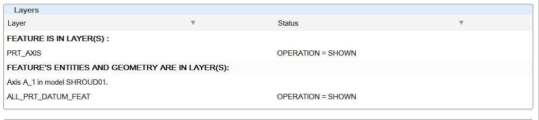

When you right click on ANY item you should be able to go to info/feature and the output should list all the layers that the item exists uponCurrently there is no easy way to find what layers control an item without going to the layer tree and doing trial and error experiments, very crude!
nevermind, apparently this function already exists.  How do i delete this?

Just INFO:
In Part mode Layer info is accessible using Info > Feature command.

It does...
