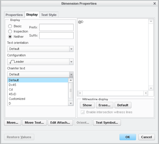

Since at least Creo Parametric 2.0, three of the 45 degree chamfer settings are incorrect.
Default and Cd use a "C" abbreviation for chamfer, which is not recognized as valid in the ASME/ANSI standards.
Dx45 has lowercase "x" and no spaces in violation of the ASME/ANSI standards.
I filed a case and an SPR was filed:
https://support.ptc.com/appserver/cs/view/solution.jsp?n=CS146957&source=Case%20Viewer
However, PTC refuses to acknowledge it as a bug and says it works to specification.
They had said they might fix it in Creo 4, but now the status is "No plans to fix"
PTC, please fix the 45 degree chamfer text so we don't have to customize every chamfer callout.

'2x45<degree>' is as seen in ISO 129-1985, figures 4, 53, and 54.  They have 'x' for various forms of repetition there.
'C2' is for the JIS standard (I don't have the precise reference for that to hand).
ASME users should generally wish to employ '45<degree> X 2'.
All of this used to be model-wide and not customizable/configurable.  Nowadays, you can set it across your drawing, but also override individual dimensions if you want to.  When you speak of a current need to customize every chamfer callout, and are seeing default=Cd, I expect you do not have the setting of the detail setup option 'default_chamfer_text' that suits your needs.  Make that 45XD and you should find things work to your taste.

Change you're drawing template or your drawing setup file (.dtl file mentioned in the config.pro) so the default_chamfer_text is 45°xd.
Also, in the config.pro add the option default_chamfer_scheme 45xd (if I'm not mistaken, it's a hidden option, so you'll have to type it in).
mender
6-Contributor
Defaults by standard are set up by 1) your template file if you are using one, or 2) your .dtl file if you are not using a template.  The inch drawing templates shipped with Creo uses 45 X D, as does prodetail.dtl and 3d_inch.dtl.  Out of the box, you won't get Cd unless you are using cns_cn.dtl, cns_tw.dtl, or jis.dtl (Chinese and Japanese standards).  Please look to your template and detail setup files, as modified/created by your company and living in the loadpoint or some company library, to fix them up.

That doesn't really help because we need it to be D X 45, but the D X 45 is wrong.
I guess it would be a little less wrong, but we'd still have to set each one to Custom.

What's wrong about 45 X D?  I don't see anything in the initial idea or the discussion to say that 45 X D is wrong.  If you meant to say Dx45, that's the subject of the bit of discussion between Stephen's "ASME only shows DIM " and my "I'll refer the question to the PM."
dhermosillo
D X 45 is preferred because that is what is called out in the ASME standard.

Good to hear you meant D X 45.  Confirming that that is indeed the subject the discussion I just mentioned, and that I am currently in discussions with Product Management on the matter.
I feel this is getting a bit repetitive, so I am not likely to post again until I have an answer from PM.
mender
6-Contributor
Hasn't quite shipped yet, but it's solid enough to announce:  I got the approval to add (as a value for default_chamfer_text, and on individual dimensions) a setting for 'D X 45<degrees>' as the text for a 45-degree chamfer.  This will appear in Creo 4 M020,  Enjoy!
