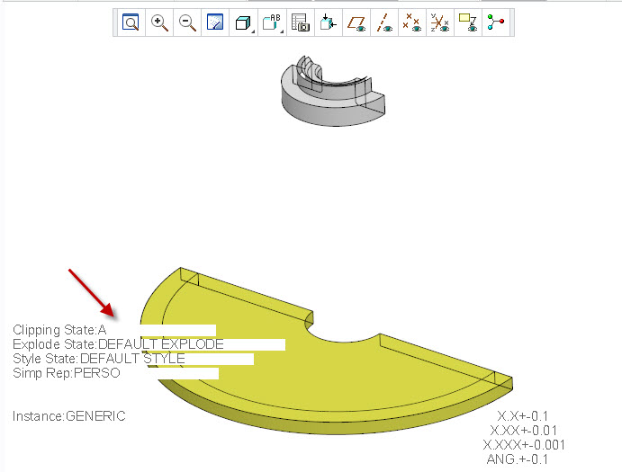

When you save a picture from a 3D model using the save as / .jpg , if the part include a family table, the generic or instance name is include on the left at the bottom of the picture generated.
If you have a combined of: Exploded State / Style / Rep Simp / Instance .... the indications are incredibly to long on the screen.
Add an option in order to hide this text on the result file.

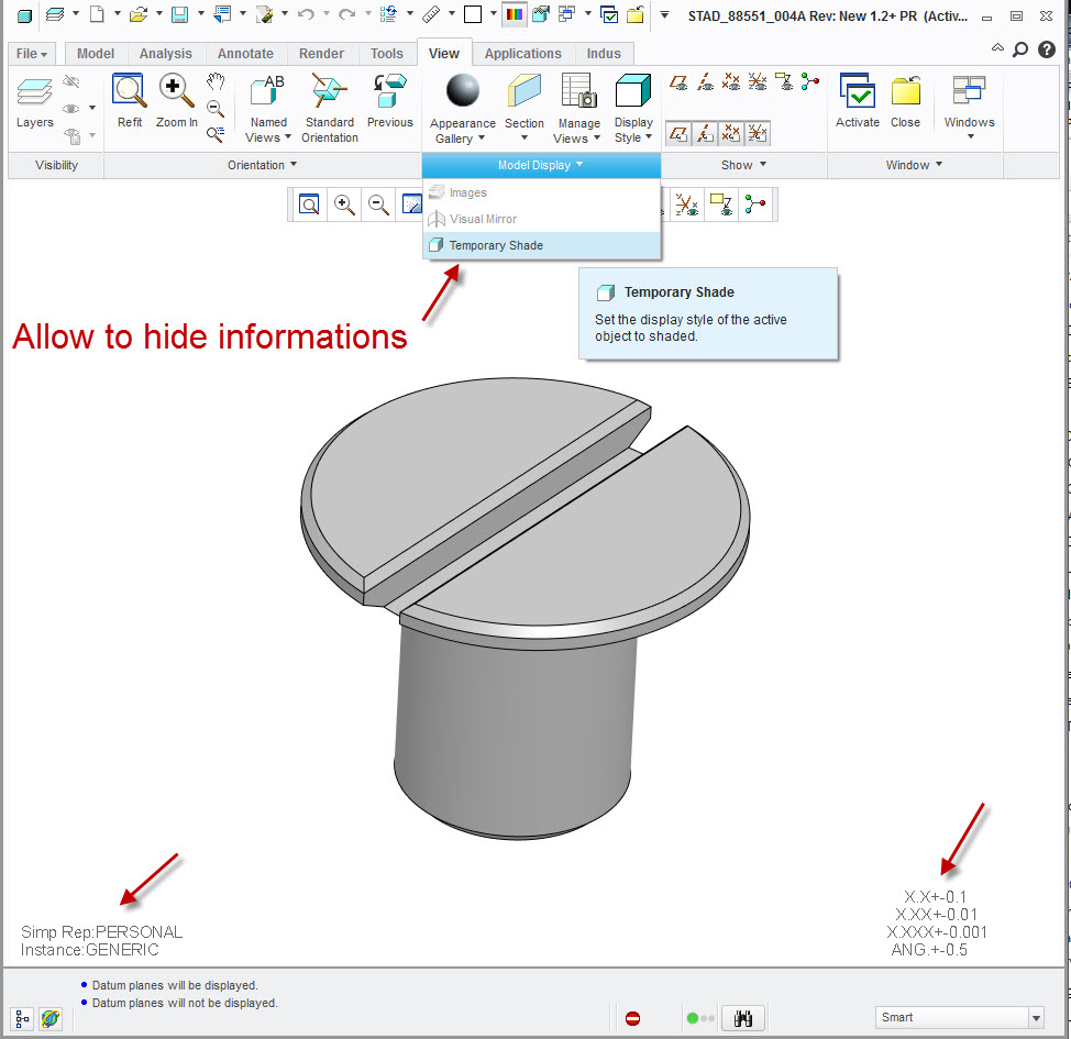

We have found that the command: ~ Command `ProCmdViewShade` Allow us to temporaly Hide the indications on screen.
Why dont put by default these command when printng in Jpeg ?
Why don't add an config.pro option to hide these information if sometimes not requiered.
