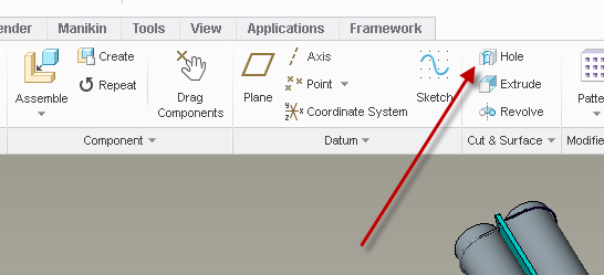

I think it would be handy to be able to with one feature at the assembly level be able to create a series of holes in stacked parts.  In solidworks there is a similar feature where you can select the parts in a stack and select the hole type wether it is a counter sink, clearance, or tapped.  This makes it easy to create different holes in multiple parts at once and also propagate the features to the part level as well.

Maybe you had something different in mind but you can add holes, extruded cuts, revolves in assembly. During the assembly feature creation, by default, the hole is not shown in the part but there is an option that you can choose to have it shown at the part level.
If you meant something different, you may want to clarify your idea.

I have used this tool to create holes in the assembly and have them propagate and not propagate to the part.  What I am looking for is a little more complex.  I want to be able to create in one go a countersink hole in the top part of a stack, a clearance hole in the middle part/s, and a tapped hole in the bottom part of a stack. Yesterday the way I had to do it was to edit each part in context of the assembly and add the different hole types one at a time.

Ahh, I understand. The functionality may already be available but in an addition paid license.
The community for IFX is:  Intelligent Fastener Extension - IFX
A video tutorial is here: Tutorial: Assembling Intelligent Fasteners

You can create the holes in the parts without any kind of extrenal reference. Just set the option USE_EXTERNAL_REFERENCES to NO.
The position of the holes is then calculated in the parts. If the position of your screw change, you have to update the position of the holes using an extra command in IFX.
