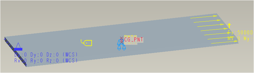

Currently the way how Mechanica reports measure results for shells is not correct. When the user measures for example a stress at a point of a shell element (compressed sheet), the measure can actually report results from the opposite side of the plate.
The following example shows a shell model with two measures. One on each side at the same location of the plate. Since the plate is loaded with a combination of bending and tension, the stresses on top and bottom are different. In that particular example the stress on the top side is -1 MPa and on the bottom side the stress is 3 MPa.
Figure 1 Example of measures on a compressed sheet

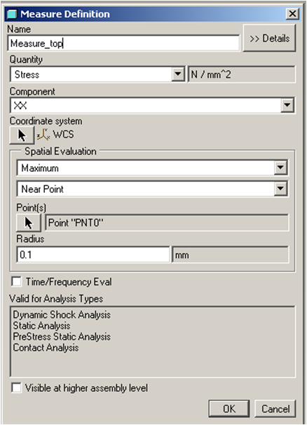

Figure 2 Definition of point measure
Based on the definition of the measure (at point) you would think that Mechanica will report the stress of the plate on that side where the user has created the point. Unfortunately that is not true. The measure will report the maximum absolute stress of both sides of the compressed plate. For that particular example the result will be 3 MPa. In that case you simply do not know on which side the stress is. Even when you create two measure each per side, you get two times the same result.

Instead of measuring at a point, the user should select Maximum and Minimum near a point with a small radius like below.
Figure 4 Provided solution from PTC
Unfortunately the reported results in Mechanica will still be insufficient, since the user still does not know on which side the stress was measured. In that case it all depends on the definition of the measure  (maximum/minimum).
