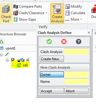

It should be possible to search for a Clash analysis in an assembly in Creo Elements Direct
It should be possible to search for a Clash analysis in an assembly in Creo Elements Direct, e.g. over
Search & Filters  -> Object Type = Clash analyis .
It is possible to search over ModelManager ClassName= CLASH_ANALYSIS, but it is not possible to search over Modeling

Hello Michael,
here a workaround for your need.
it is only necessary that all Clash analyises starts with "clash"
Best regards
Friedhelm

Hello Friedhelmk,
this is not what I'm searching for . I want to search for "clash analysis"
MaxR.Kublin
Well, what you want to have can be done via LISP (using IKIT).
mschmidt-3
3-Visitor
Thank you for your note . We know that it is possible via LISP, but we want to have it in the standard functionality .
