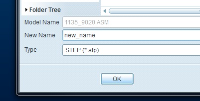

When saving a step file, if you type in the new name first (image 1), then select step file (image 2), the file name switches back model_name (image 3). Then you have to go back and select the file (image 4) and retype the name you want the step file to be named in the first place (image 5). Please correct so that the file name you type in for new name stays the same if you type it in and then change file types.

But I don't want the filled in name (whether part or asm) because our part names differ from our model names (it was that way when I got here ). So if I want a .stp file for part ABCD which is model 1234.prt, I type in ABCD in the new name box and then select .stp for the type and it goes to 1234_prt.stp instead of ABCD.stp which is what I typed in the first place (i.e. it overwrites what I manually put in the new name box.). I hope that better explains it. This is also true for .pdf's and .stl's as noted in the suggestion too.

I am reviewing this request with development to see if we can make the entered name persistent when changing format type.  It seems logical that if you have entered the desired name that it should be preserved in the New File Name field.  Based on the layout of the dialog, your defined workflow should not clear the entered name based on the format selected.

I wanted to give an update on this 'idea' request.  I am happy to say we are updating this limitation to preserve the entered file name when user changes the desired format.  This means if a user enters a custom name and then selects a format, we will not switch back to the Model_Name.
