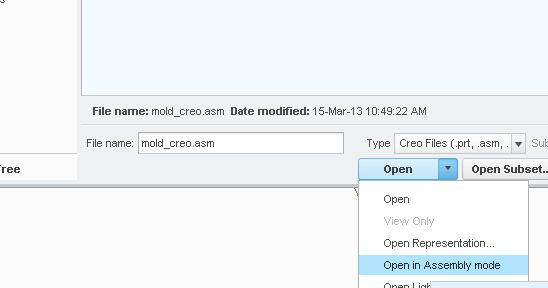

To open a Mold asm only in ASM mode (without using a Mold License) is only possible
with a special config.pro option (allow_asm_in_assem_mode). If this option is set to yes,
a new method to open files appears in the file open dialog (Open in Assembly mode).
It would be easier without an extra menue entry in the dialog if creo recognises that there is no
Mold License and automatically opens the asm in asm mode instead showing an error only.

What release & version of software are you using? Config option (allow_asm_in_assem_mode) does not work for me in Creo 2.0 M090.
OliverHeins
We use the Creo 2.0 M060 right now. We have an Call for these issue. Even if it would work why should the user select a different way to open the model? It should work automaticaly.

The option is allow_mfg_in_assem_mode to yes referring to article at https://www.ptc.com/appserver/cs/view/solution.jsp?n=CS67592
