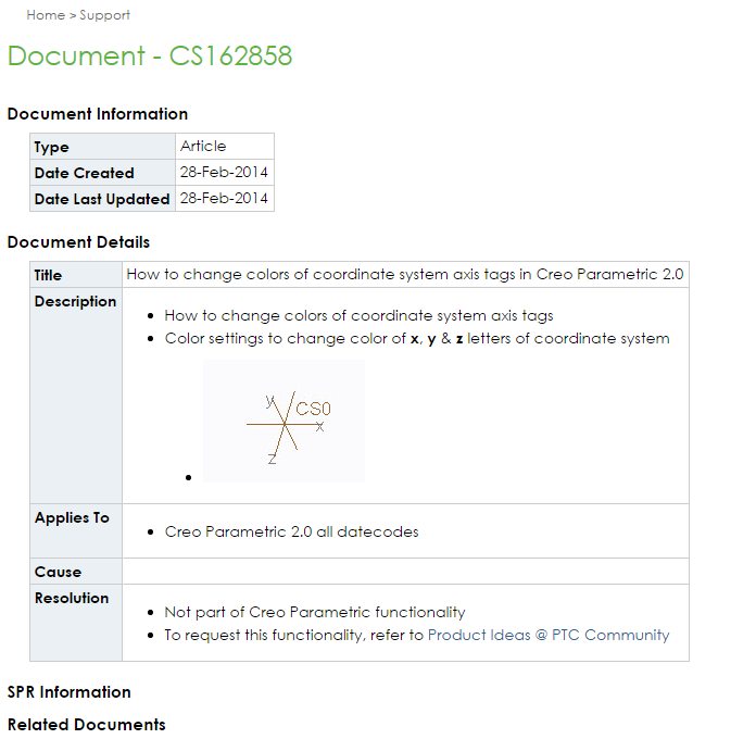

I'm currently trying to make the environment of PTC Creo look pretty and I have been able to modify quite a few things. Still, I am a bit annoyed that I cannot change the axis tags colors, positions, and sizes. To me this doesn't represent a very difficult task for the programming (I am not an IT though), and I think this would allow users to get better experience of the PTC Creo softwares.
As showned in this photo, there is apparently no workaround for it in the moment :

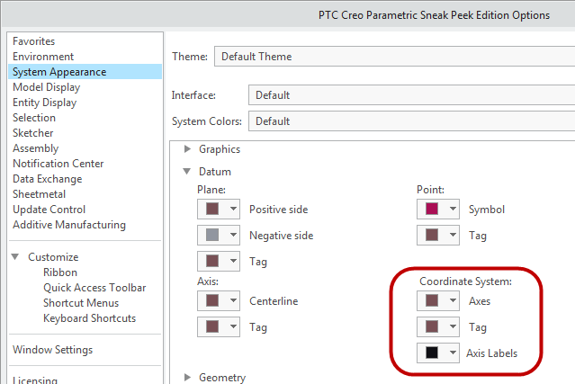

In Creo 3.0 and earlier, you had the possibility of changing the color of the CSYS axes and the tag, but it is not possible to change the color of the axis labels (the x, y, z).
I'm happy to say that this will be addressed in Creo 4.0, where you can now specify the color of the axis labels:
In addition, we've also updated the structure and appearance of the coordinate system to look more like what is expected as a coordinate system and what the standards show as the expected appearance. The axes now only extend in the positive direction, there are arrowheads at the ends of the axes, the labels are in uppercase and positioned where they don't overlap the axes.
For now I'm going to mark this as Implementation in Progress until we actually ship Creo 4.0 F000.
