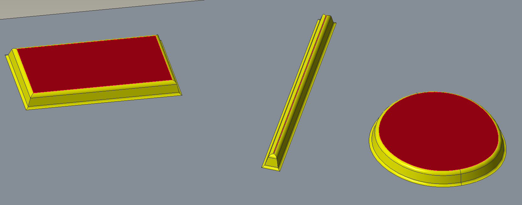

Hi I design many embossings and I think brilliant new feature can be "Bump-map emboss feature" which base on grey texture (same like for bump in rendering), will add physical surface mesh deformation.
It means if texture is black - the concave is "0" if it is white the deformation reach maximum pointed in the feature parameter.
This figure will express the idea in cross-section and below is referenced texture image:
of course it should work in UV directions, just like a bump

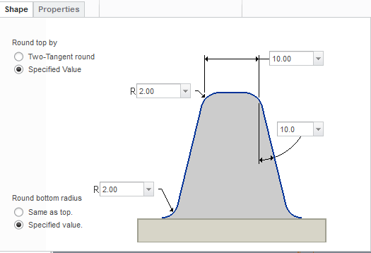

Good reference for this idea can be rib feature:

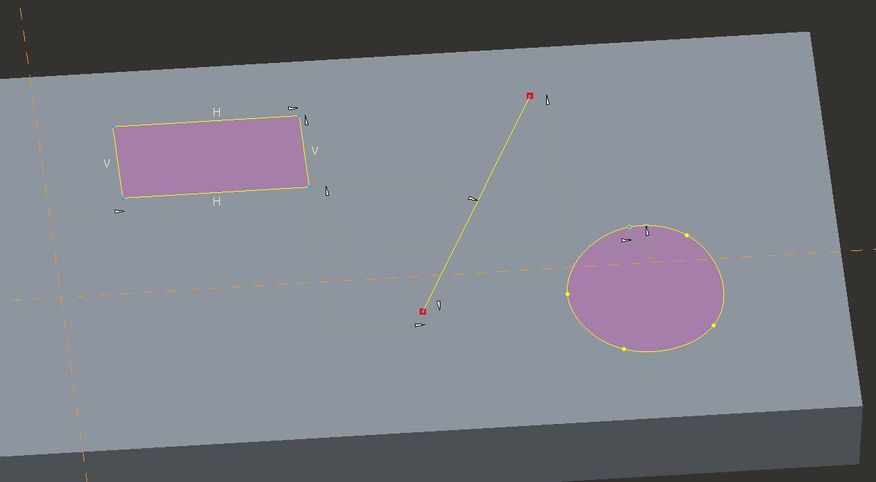

where in option user can set minimum side angle, radius value at beginning and at the top, so in this new feature Creo will calculate all - even if user prepare just white max deformation texture or parametric sketch can be source representing max deformation.
Example sketch:

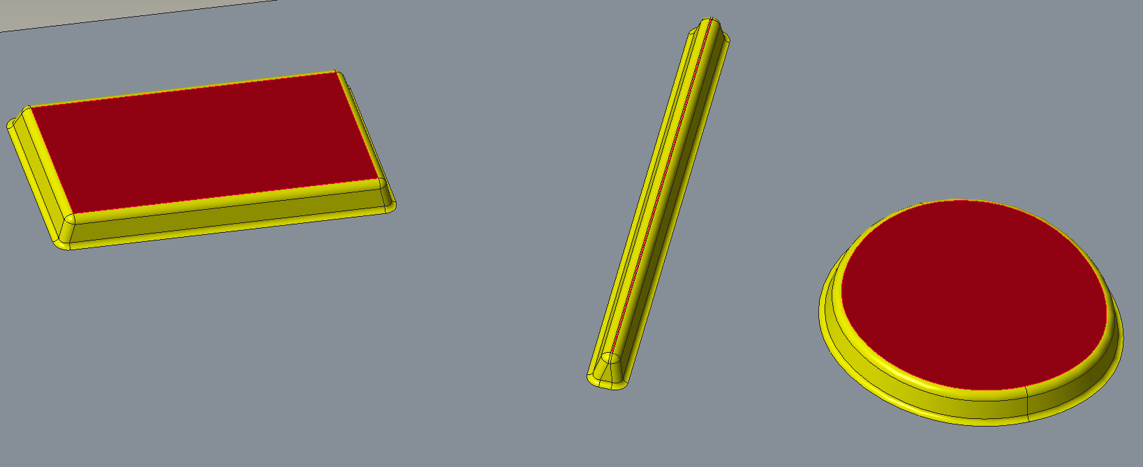

Then result can be as follow:
will be great also to be able to add rounds at corners:
also be able to set the minimum width on the top:

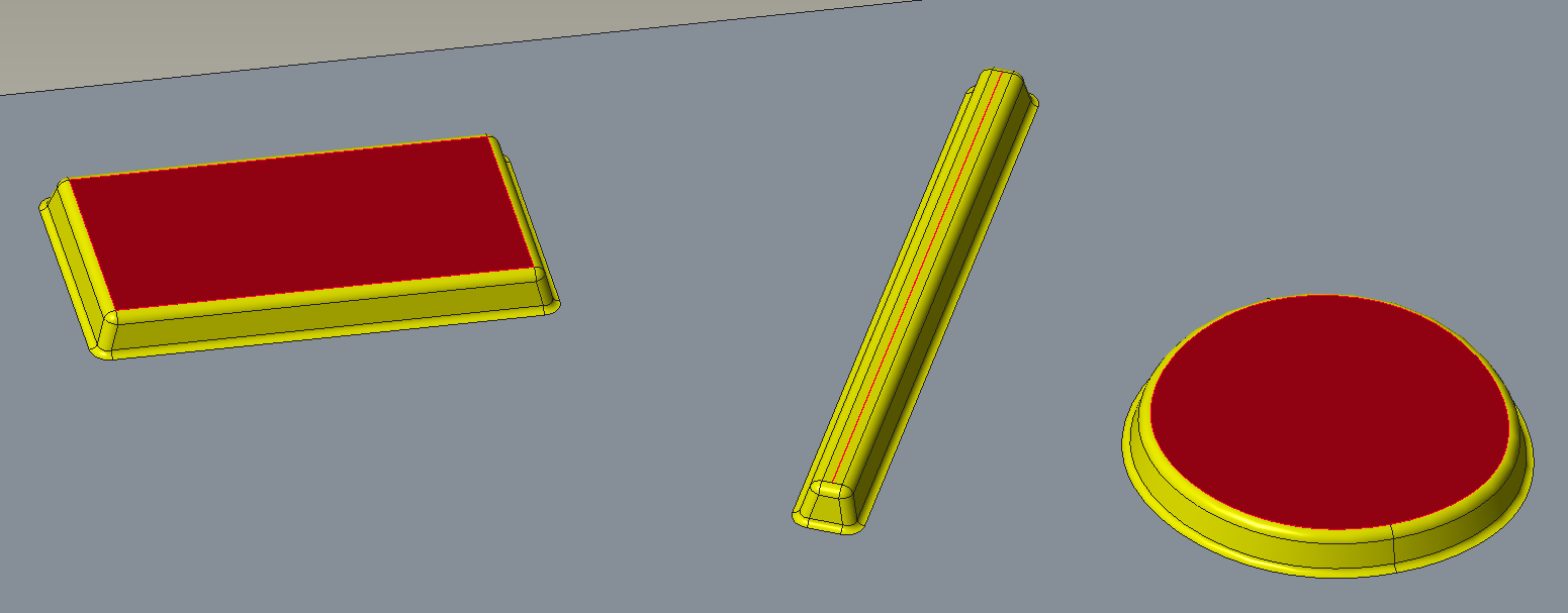

next level will be if corner rounds will be no constant, but be result of side angle:
if it will work on non flat source surfaces like offset with draft it will be perfect!
