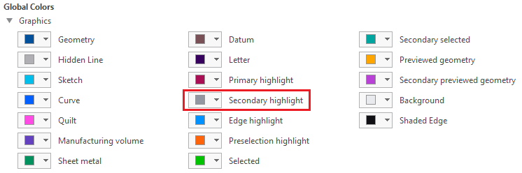

By the way, the color of this text is controlled by the Secondary highlight system color.
The shift that occurs to both the background color and the secondary highlight color during print preview seems to be hardcoded.
