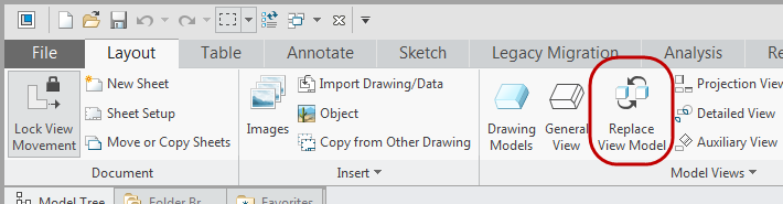

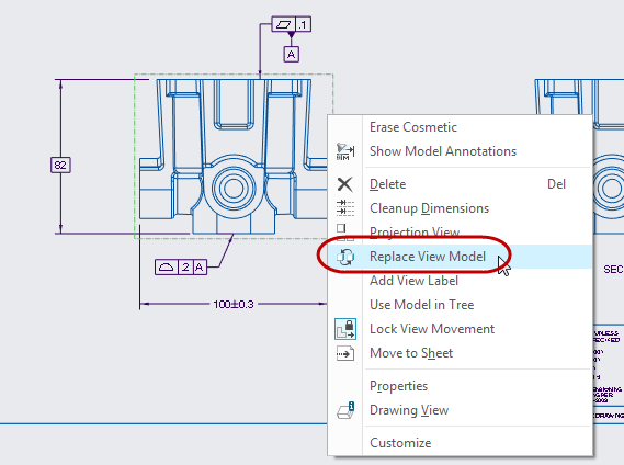

The ability to replace the model of a drawing view with a different simp rep at the Part level is indeed there in Creo 4.0, it's just maybe not in the place where you expect it.
This enhancement was added as a command available in the Ribbon and in the menu that appears if you right-click on a view.
So, it is available as a command that is executed on a number of views instead of as a modifiable property of a view. There are some technical reasons why it was done this way, some of it has to do with the fact that we're leveraging the same functionality for replacing a component in an assembly. You'll notice the dialog that appears looks familiar as the Component Replace dialog from 3D. In addition, by making it a command we can apply it to a number of views all at once. Views that have a dependency (projection views, detail views, etc...) need to be replaced at the same time since they would, of course, be expected to be of the same model, but you can also add all views on the sheet/drawing that currently match the same model/rep. We also provide the ability to delete the old model from the drawing if you replace all of its views and we can also replace any callouts that refer to the model which aren't a part of a particular view.
I'm going to mark this Idea as Current Functionality now that it's been implemented.
For some more details and to see a short video of this enhancement in action, check out the What's New page in the Creo Help Center for this enhancement:

The below mentioned functionality "Replace View Model" that was introduced with Creo 4.0,  now allows to replace a Master rep that is applied to some drawing views by other Simplified Rep of that part
LawrenceS
18-Opal
@RaphaelCNascime , @Mfridman ,
This is beautiful!  I tested in Creo7 and it seems to work perfectly well!  Thank you!
