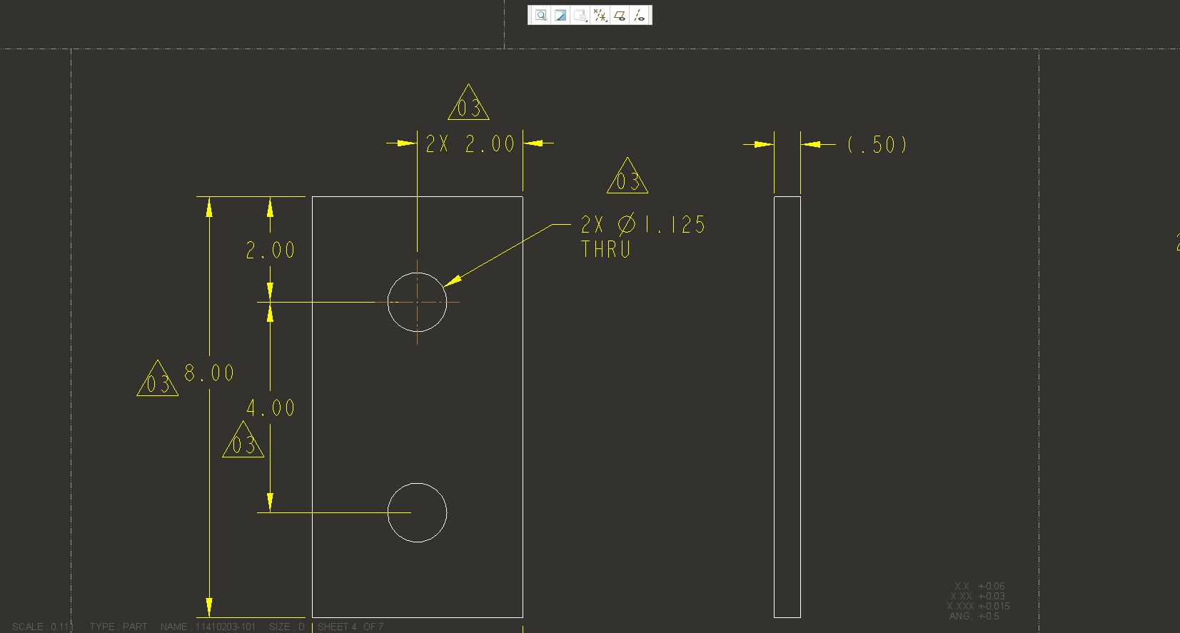

This is how we mark drawing revision changes. We use a revision symbol that is a triangle.
yyuan
1-Newbie
Thanks Stephen.
I use this symbol too. Beside it, I put cloud line as well to clarify exactly what is changed. And for feature changes, either adding or removing, I think cloud lines are necessary to clarify it.
