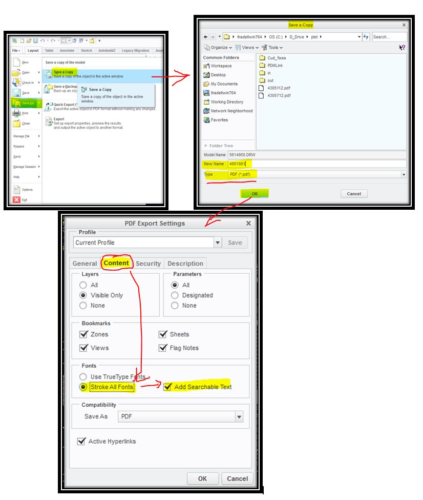

We already have this functionality in ProE WF4 and is also in Creo2.  Try to do a save as/save a copy then select the format to be as a pdf.  Make sure to stroke all fonts.

The solution can add an option like "Add searchable Text" when PDF output is selected (like in Creo Parametric) so the customer can decide if the texts will be maintained od converted in the PDF files

I use the a mapkey export output puff searchable like lsheeler states above but in general column enter monochrome and 600dpi. Works real well only gripe is the Datum test is use on model for marking, connecters etc isn't as clear as I would like.  Other than that it works great.  Anybody any ideas for better datum tests?
