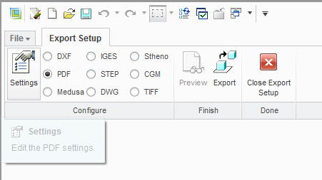

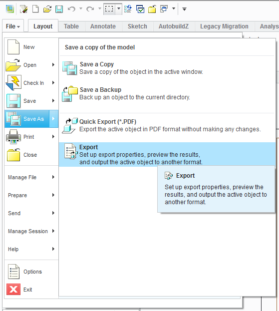

Are you talking Drafting in Creo? There are a couple of ways to make text searchable. One is to use TrueType fonts. The other is to Stroke fonts and make them searchable.
Save as > export
Settings
Content Tab > Fonts
