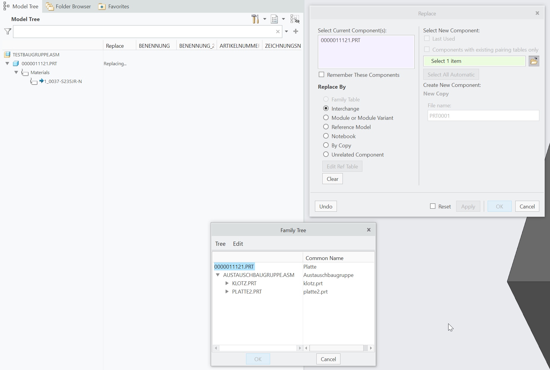

If you replace a part in a assembly by a part of a interchange assembly you have only two columns for part name and common name shown in the dialog. Is it possible to view the parameters defined in the parts in the Model Tree so that you have more information to decide which model to use to replace the existing model?
