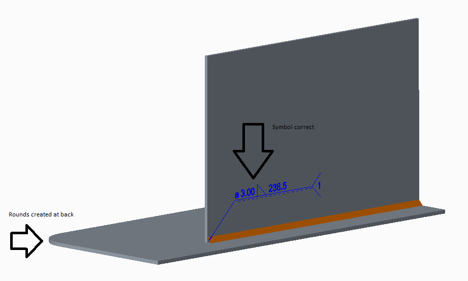

For example: Here is a weld assembly with a weld feature (symbol is correct) and rounds created at the back (to help distinguish between back and front in drawings)
