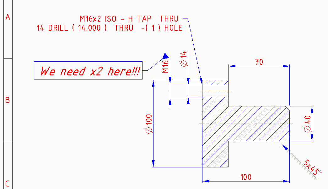

Standard hole dimension cannot display the pitch of the thread in Creo Parametric
Standard hole dimension cannot display the pitch of the thread in Creo Parametric.
Standard ISO hole thread property can only be displayed in the note, not the hole dimension.
At this time you must set pitch as text manualy.

You can manually add the pitch parametrically, in the form:
M@Dx&PITCH:FID_nnn
where nnn is the Feature ID of the hole.  Optionally you can add [.2] to the end to display all pitches to 2dp, e.g. M6x1.00, M8x1.25, M10x1.50.
However, I agree this is a real PITA (partly because you have to jump back to the model to find the FID of the hole) so some form of default option to do this would be great.

It is usual to show the pitch in the dimension  only  in case it is not a rule thread (DIN 13-1).
That means for standard thread ..., M6x1, M8x1.25, M10x1.5, ... M16x2, ... it is normaly  not required  to show the pitch value in dimension.
But for other pitch it is required to show the pitch value in a engineering specification (drawing) (e.g. ..., M10x1, ..., M16x1.5, M18x1.5, ...) .
