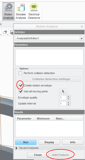

I think this can be done by creating a motion envelope in motion analysis. http://youtu.be/qZCStk9TqV4
To have the envelope stay, save the analysis as a feature.

I'm sorry, but that won't help since that functionality is in Creo Parametric and I'm running Creo Elements/Direct Modeling.
