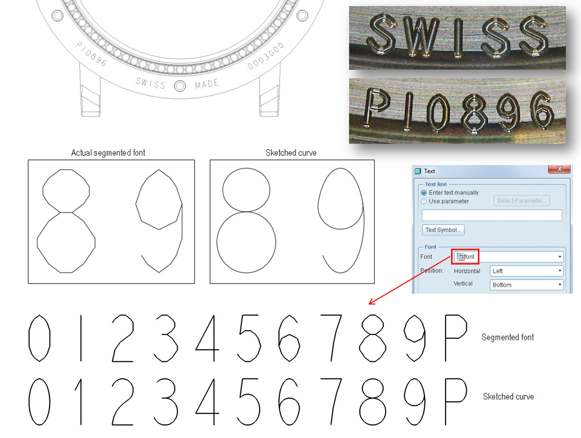

Wireframe font named “font” is too segmented.
Wireframe font named “font” is too segmented. We need a smooth font with a minimum of entities.
A better Pro/E or Creo font should be created or the original Pro/E “font” modified.
Non-linear entities should be defined as arcs, ellipses or splines as illustrated.
An enhanced wireframe font would improve the quality and the time of CAM engraving tool paths.

Hi @NicolasBourgeoi1 ,
We have introduced new default fonts with Creo 4.0. Now the default font is Arial WGL and it is not segmented as the "font" font
Does this font achieves the requirements from your POV?
