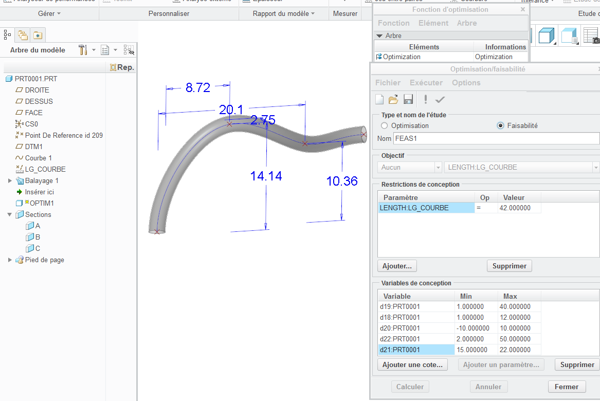

I create a feasability feature to define the lenght of a pipe.
when I assemble it in a product, I can move the extremity points with flexible component feature, using the distance method.
but for the intermediate points, those calculated by BMX feature, I'm not able to add a flexibility because there is missing a method option like "relation".
so it would be very usefull to have this "relation" method, don't you think?!
