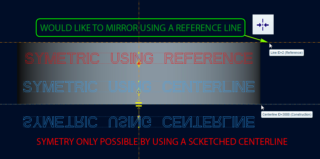

I would like to be able to mirror sketched entities by using a reference line.
Today, I systematically need to sketch a centerline before mirror command.
WildFire 5.0
  1. Reference
  2. Sketch centerline
  3. Sketch entity
  4. Mirror entity
Evolution for faster sketching
  1. Reference
  2. Sketch entity
  3. Mirror entity
If necessary, the system could create a centerline when the user mirrors from a reference line.
