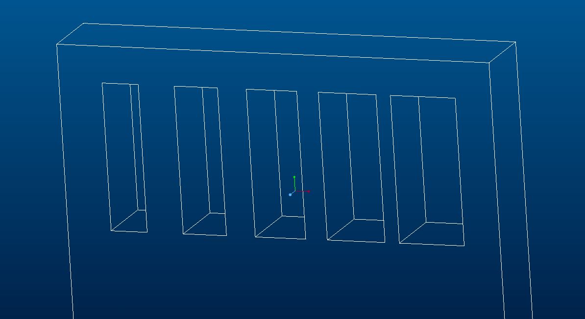

Some situations need to create the same form ,but their width or length is different
Bellow picture
I can pattern a lot of hole, but I need to move their face to n+1mm one by one.
Maybe the pattern can pattern the same form and change their width or length.
Like creo parameter pattern function.

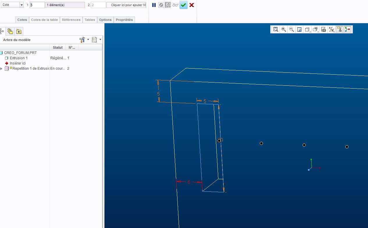

Select both dimensions (Ctrl + LMB) for the pattern. You can choose different increments for each Dimension.
pperrin
1-Newbie
Right, idem with captures to follow the creation process
Feature creation + pattern
Selection first pattern direction (5 mm from the vertical side)
Enter pattern step, (here 10)
Enter number of repetitions and validade
Press CTRL and select second dimension (here width), then enter pattern step for this dimension
(1 element(s) becomes 2 element(s))
Voilà!
5 different shapes: step of 10 mm and +1 mm by repetition (from 5 to 10 mm wide)
