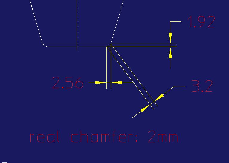

placing a chamfer on a conical part is not recognised by annotation
if you try to annotate a chamfer that has been placed on a conical part you get an error: "The selected element cannot be used to create a dimension of the current type [Chamfer-Dim]. Please select again."
so i tried using the default linear annotation commands, but the outcome is not as desired.conical_chamfer.JPG
4 Comments
FriedhelmK
Hello Ward,
you can use the PRP = Projected Reference Point to place the dimensions
FriedhelmK
In drafting it also does not work
Would you please add Drafting to the categories?
Concerning the "projected reference point" you can view the following ideas.
The links do not work correctly and must placed by copy and paste into the address field
http://communities.ptc.com/ideas/2402
and
http://communities.ptc.com/ideas/2442
