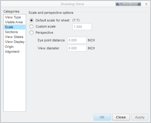

In Creo Parametric 2 or 3 in drawing module user can't change a scale of an "additional view" - it have the same scale that general scale of the sheet. Why it's not possible to change? Every time all of users need it, but only one way it's trick to make general view and make a fake arrow Please fix it.

Creo has the ability to make additional views at different scales. see image, view properties dialog window

When i try to change scale of additional view it's blocked. Of course i can change type of view to general and change scale, but i will lost of view arrow..

I simply create a cross section outside of the part so my arrows can be shown using the view properties - section. The view is an authentic view, to the scale I want it to be and it has the arrows I require. The only "added" work I do is adding a cross-section to the model and changing the view name from "section a-a" to "view a-a"
