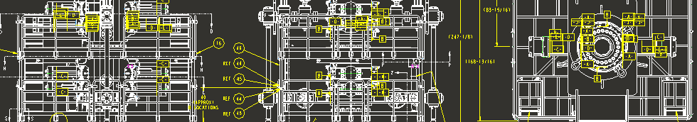

Just today, I grabbed this image. I needed some quick dimensions to give to a customer so they could verify the product would fit in their application.
Who would have thought that the datums would SHOW BY DEFAULT...well no one would have ever of thought that because NOTHING else in Creo/Wildfire/Pro/E works that way. Every drawing comes in with nothing showing, no dimensions, no axis, no GD&T....nothing...but PTC knows that everyone wants to see all the GD&T datums of all the parts of an assembly on every drawing ever built that uses that part/assembly, that's why they have chosen to show those by default.
Yes, I know I could turn the datums off by layer (except for those created after that lovely annotation datum /combined state fiasco) assuming the people who created the datums put them on a reasonable layer (never a guarantee of that). BUT why should I have to do that??? I don't have to layer off every dimension of every part and assembly when I create a drawing. I don't have to layer off every axis of every part and every assembly when I create a drawing. It's because they don't show by default.
Am I going overboard, well maybe a little. This one little thing just bothers the ever-living bleep out of me. If I check in my drawing and then later have to go get that drawing back out fresh, it is almost 100% that I will have to fiddle faddle with the datums again. They have this amazing ability to come back, magically reappear...how to they do that, THEY SHOW BY DEFAULT, is how.  WHY!!!????!?!no-show-datums.jpg
