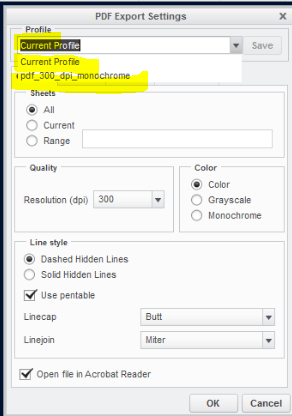

As a workaround You can use the following config.pro option:
intf_profile_dir
intf_profile_dir  specifies the directory where import and export profiles are stored. Use the full path to avoid problems.
Then store your profile pdf_export.dop in that directory. From now on you are able to select the profile fron a drop-down list in the PDF export settings
