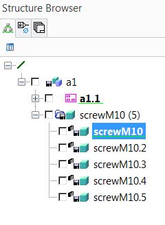

When creating a BOM of an assembly which contains shared parts, the name of the shared parts in the BOM is the instance name of the last created instance of these shared parts. While in the structure browser the shared parts are grouped in a pseudo-folder and the name of this pseudo folder is determined alphabetically.
I think it should be better if the BOM entry would be given the same name as the pseudo folder, or at least the option should be provided in the default settings.
I know that adding a model name to a part overrules the instance names and solves this issue, but I don't want to change all my assemblies, I would like this to be default.
