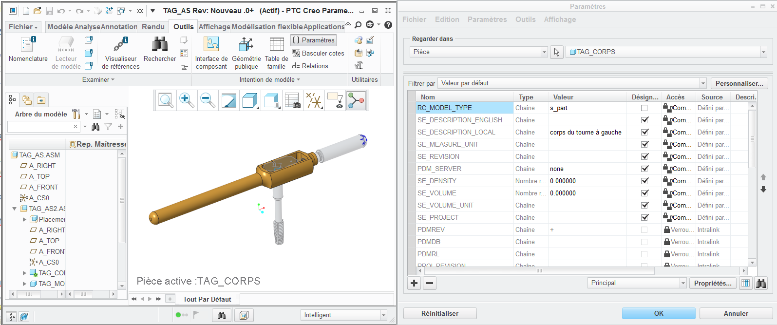

but I'm surprise about what you say: you can see the parts attributes in CREO ILLUSTRATE when you import a native file?
could you also have the orientations, exlpode states and combined views?
I come to try, and I do not have anything of this, plus I cannot update the DATA...
this is what I have in Parametric, after a modification:
and what I see in Illustrate:
