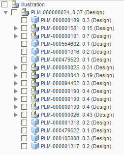

I think it would be a great idea to add more functionality in the Creo Illustrate modeltree.
As far as I know it is only possible to show the Number from a PDMLink PVZ file.
In our system it looks like this...
In Creo View it is possible to use alternate names in the modeltree.
The the same dataset looks like this...
I use the datastructure very intensively when I work with Creo Illustrate and therefore I really miss the functionality from Creo View.

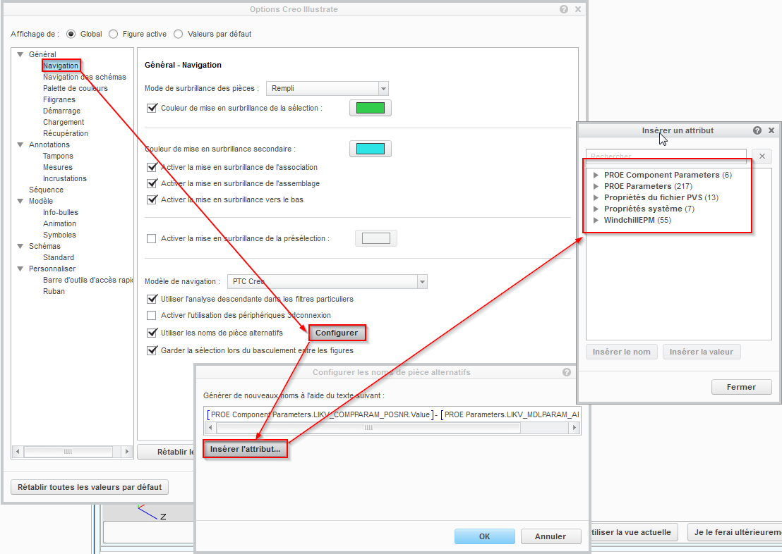

I think that is possible (as in CreoVeiw) with the latest CreoIllustrate Released (3.0 M030) :

hello guys,
this is an option available in PTC CREO ILLUSTRATE 3.1 F000
I also not have the option in 3.0 M030
Ron
lkoeniguer
Yes, you are right.
Sorry for my mistake, I use the new release 3.1 F000.
TommyRasmussen
8-Gravel
It's great to see that PTC has included this functionality in 3.1.
Thanks a lot for your input!
