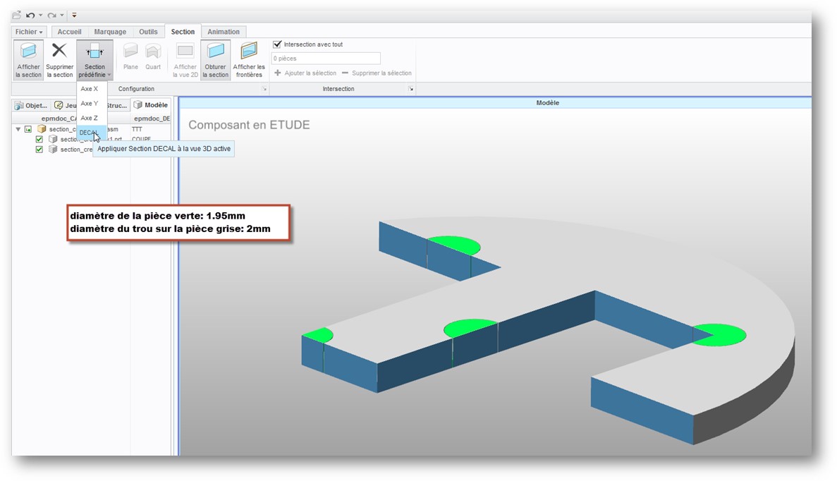

Displaying a published "Offset Section" of an Assembly, some components are sectioned with missing surfaces
Please enhance the visualization of the Offset Sections in CreoView.

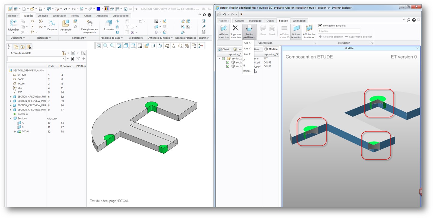

Offset section is OK in Creo.   It is KO in CreoView

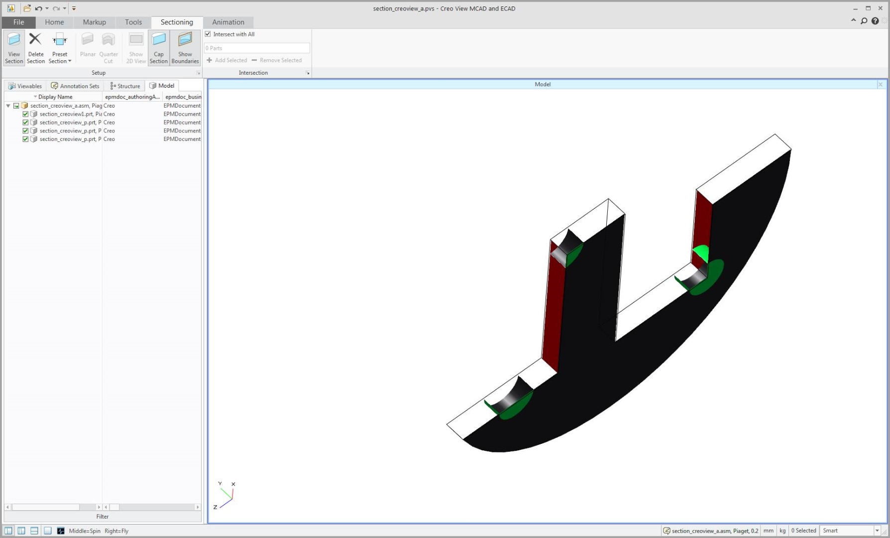

When displaying published Offset Section of an Assembly in CreoView (from the Sectioning > Preset pulldown), some Parts are sectioned with missing surfaces (not capped/closed).
For example (If they are same size or larger than the holes, the issue occurs😞
The Planar Sections are OK in CreoView (even if components are in contact).
The Offset Sections can be OK in CreoView if there isn't any contact between parts:
