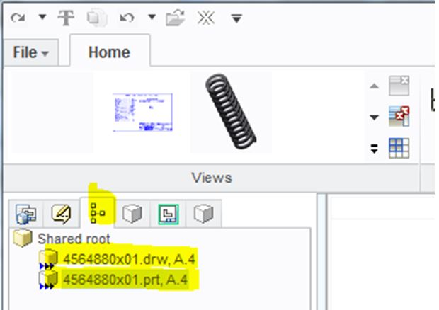

I use both methods, depending on the situation.  I think the key may be dbl clicking on the objects in the tab and column  for the Shared Root, because CV is often a blank screen before those are selected.
