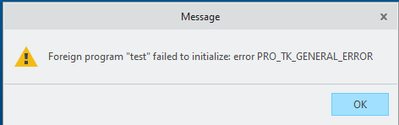

I've been using VB API for a couple of weeks now and now i want to add a button to the ribbon. But I can't even start an application in CREO.

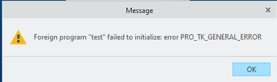

Errors that I'm getting

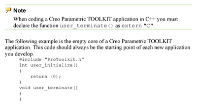

VladimirN, thank you for those materials bu the didn't help me.
Is there anything like this for VB API. I've found it in user guide for TOOLKIT.
I'm able to start and use scripts that I have for now by running them in visual studio but I can't register application in creo.
Some solutions for this error:
All those articles are for TOOLKIT but I'm using VB API.
