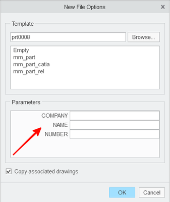

Designated parameters you can fill in "New File Option" dialog during creation of new model.
This list can be very long if you are using a PDM. It does not look like it is possible to sort the parameters in this list.

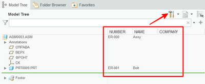

You can show parameters in the Model tree. You can even enter the value from an assembly for all the parts and subassemblies it contains.
I am using creo 9.0, but new file option doesn't show the above format. Is it a new version or a ui customised one?.
Thanks again..
Parameters must be created and designated in the model template to be displayed in the New dialogue box.
Create a model using this template.
Set the template_solidpart, template_designasm config.pro options to point to your templates.
