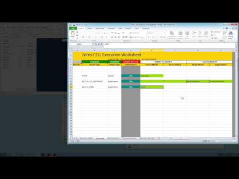

While the responses to the original post where a bit humorous ... this is a common problems.
We did something like this with Nitro-CELL years ago to do this.  The same principle can be done with CREOSON (for free).
Nitro-CELL UseCase Breakout Family Table Instances
Dave
This is a use case demo of how to use Nitro-CELL to breakout family table instances from a generic using a batch worksheet to iterate through instances within part model that contains a family table. Get your FREE Download and License now at: https://www.simplifiedlogic.com/nitro-cell
