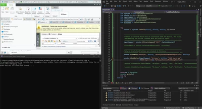

Hello no matter what I'm doing button doesn't appear in menu. What am I doing wrong?
Whole Code
