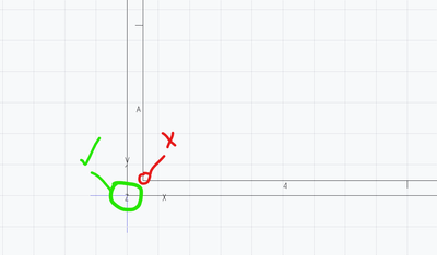

We have a C size drawing that the left and bottom margins are off the page. I have struggled with how to even ask this question. I am aware there are differences between format and template, but I don't know where to start.
I just want to "rightsize" our C drawing template to export with correct margins, not offset as they are now.

It looks like someone positioned the border at the 0,0 corner of the drawing instead of shifting it up by however much border they wanted. Easy way to tell is to turn on the grid display and look at where the origin is at. More than likely this is set in the drawing format and will need to be adjusted there. If you're willing to upload your C size format as an attachment (zipped), I can take a look.

I'm assuming this is the exported file (shown in your image). Could you also send a snapshot of the same drawing within Creo? There are a number of reasons this could be happening and it may take some Q&A before we zero in on the root cause. Some things I would want to check (I'm sure you have done most of these, just asking to make sure all possibilities are covered):

2. Is the "zero point" (0,0) location for the format set properly at the edge of the format or is it possibly at the inner edge of the 1/2" margin frame? (Hard to explain but hopefully you understand what I mean). -I don't know, nor how to check, these templates pre date my employment.
3.What type of export are you attempting - or are all of them experiencing the same issue? For example, exporting to PDF versus printing directly to a printer. Are any of them working properly? Also... what steps are you using to produce your output. There are about 3 ways to print a PDF and sometimes the output differs. -This is a .pdf export with a hotkey (PDF). A,B,D all export fine. This issue is isolated to the C format.

Literally, I think Tom (above) hit it with his first response. I think on the C-sized format, your "0,0" position (the format origin) is set to the wrong location. Your plot settings show "Full Plot" and an X and Y offset of zero. The preview being off really just confirms the likely issue is a misplaced origin.

So close! I've found most of what you mention. I can find the origin command box and turn on the grid. I don't see a save setting or really think it is modifying the format. I clicked the "default" and nothing changed. I also tried to move the origin by one cell kitty corner left/down but the dot does not follow the YZX symbol. I've been updating/regenerating/uploading after changes, but see nothing. So close! I'd love to bring this solution to the team. I'll speak highly of you all 🙂

You can move the origin for the grid around, but that doesn't actually change the origin of the drawing. Setting 'default' on the grid origin just snaps it back to the 'real' drawing origin. You can't change the drawing's actual origin. Instead, you just grab the border lines and move them to wherever you want them relative to that origin (or sketch new ones.) Setting the grid to some common increment (1/8", 1/4", etc.) and then configuring sketcher to snap to the grid makes it really easy to sketch these lines. Holler if you need help and I'll try to record a video.
