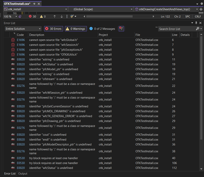

Like These types of errors i am getting,
Ben_C
(To:PH_10785300)
Those errors suggest that in your project properties you have not included the directories where those header files exist , e.g.:
The paths you would need to include are:
<Creo install loaction> \Common Files\otk\otk_cpp\include\
<Creo install loaction> \Common Files\otk\otk_cpp\otk_examples\includes\

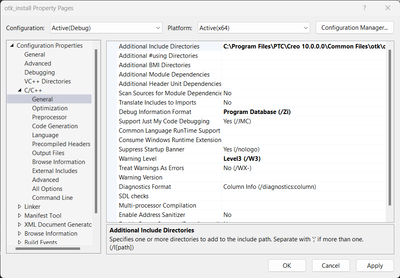

PH_10785300
(To:Ben_C)
After including Directory i a getting these errors. please help to solve this
Ben_C
(To:PH_10785300)
You cannot launch the compiled application directly from Visual Studio, you need to launch Creo with your application loaded and then "Attached to Process" Xtop.exe from within VS.
Look into <Creo inst>\Common Files\protoolkit\Creo_Toolkit_GSG.pdf for initial information and Chapter 94 in tkuse.pdf for a more in depth guide.

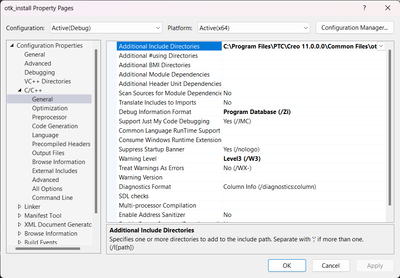

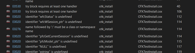

PH_10785300
(To:Ben_C)
Also i am getting same error like before,
after adding the path of the directories.
and in empty screen i am getting error like
please help me to solve this
