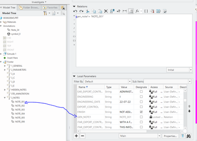

no I'm trying to create the parameter gen_note1 as a note parameter through a relation like parameter A here

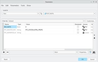

so there are 5 parameter types real number, string, interger, yes no, and Note. I want to create a note parameter through a relation instead of the + symbol.
I can make the other parameters through relations like note="1" for sting or note='1' for numbers but i cant figure out the command to make a note parameter called Gen_note similar to the parameter seen in A

Creo parameters of type note properties:
◦ Note—The value for this parameter is the ID of a model note.
In order to designate the ID of a model note that note must exist prior to the creation of the parameter. This is why if you create a parameter in a model without a note you can not even select the note type.
If we assume at least one note is present in the model (Note_0) then you would need to create a relation that could obtain the note ID and assign it to a parameter "Gen_Note" and set it to type note. I am not aware of any method for a relation to "query" the model to obtain an annotation ID from an existing note. It is in theory is possible to assign it to a parameter  but the only way I can see currently is if there is a set system syntax for a model note ID (an analog to FID:Feature_Name) to use in relations and you made an assumption about the existence of the note.
Maybe someone else can add if such a syntax exists for a model note ID when used in a relation.

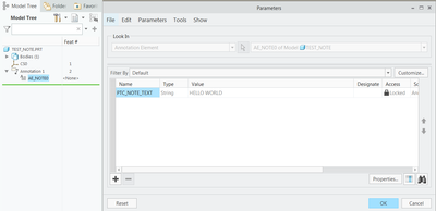

Yes, here is a sample drawing and model (Creo 7) that implements the scheme you describe above.
There is a parameter generated within a model note as seen here. That can be used in a relation.
Here are the model parameters used to generate the note seen in the drawing

KB_9100625
(To:tbraxton)
so how do i find the info in the first screen shot?
tbraxton
22-Sapphire I
(To:KB_9100625)
Select note in the model tree RMB and select parameters from the drop down menu.

@KB_9100625 wrote:
OK i think i could work with that. do you know if there is a way to relate the info in a note to a parameter. ie if the note says hello world can ti do something like &note and it would appear in the parameter?
maybe following information is the right one.
I found https://www.ptc.com/en/support/article/cs121489 article. It says that you can use following syntax:
MYPARAM=PTC_NOTE_TEXT:NID_AE_NOTE# (Where # is the ID of the 3D Model Note).
In attached Creo 4.0 model I used following relation:
x="<<< "+PTC_NOTE_TEXT:NID_NOTE_001 + " >>>"
