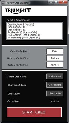

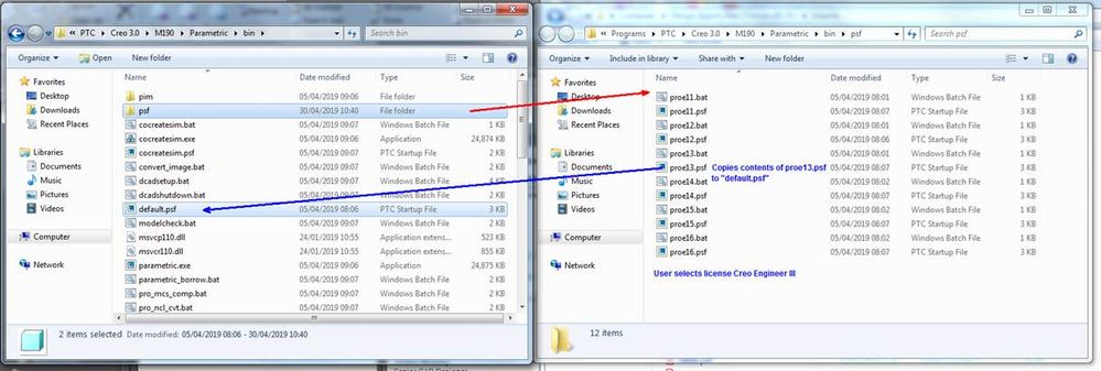

What we have done is put the psf files in a sub folder within parametric\bin directory, then our custom Creo Launcher executable copies the psf file (based on the users selection from our custom windows form) into the parametric\bin directory and re-names it default.psf then waits 0.5 seconds then start parametric.exe which then only find one psf file, this way we don't get the Creo license pop-up but we are still able to select licenses from our Custom Creo Launcher. The Launcher is still beta testing at the moment but we would be happy to share the code for anyone interested in making something similar.

What is the advantage of this over what Martin has suggested above?
We have just dumped all the psf and corresponding .bat files in the bin folder and when the user launches Creo it asks for which psf to select. This is simple or did I miss anything?
Yes that's what we currently do, but we wanted to build own Creo Launcher app as above to select the license, manage configs, manage cache and log crashes. In the future we will build more features into this app to show license usage and define set environments for users to work in (ie set a config, syscol, UI, tree) depending on what task they have.
