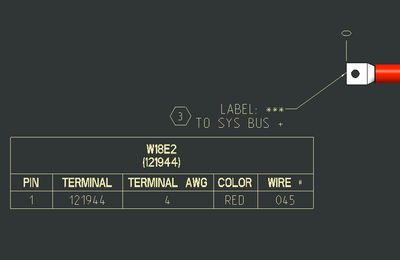

If my model changes and the note becomes unattached, my textline "&REF_DES:AT_CONN" calling a parameter changes to "***".
Once I go through and reattach all the leaders, I can run this function to update all the notes back to "&REF_DES:AT_CONN",  It only works if I've double clicked to edit the text before hand.
Has any one else had this issue?  Does Toolkit also have this issue, or is this solely a weblink problem?

Creo 9
I resolved the issue.  The *** was being broken into a seperate text.item, so I updated my code to reflect that.  Below is the functional code.

3 REPLIES 3
Erase (hide) the note before edit. Then show (display)
That didn't do it.  I didn't realize before.  It's actually crashing on these notes unless the textbox has been double clicked.
EDIT: Nevermind.  It's not crashing on those.  I just had a bug.  It's still not working as intended.  It's not changing them.  I can see them being hidden/unhidden.
For reference, I attached a picture of the note, as well as the code with your suggestion implemented.
