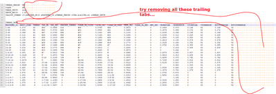

Hi @CB_10314989 , My concerns:
1) your file is called UNC.txt, instead of UNC.hol
2) the file has a lot of trailing tab characters, which creo might not like...
Not sure about #2, but how your custom file is deployed is a mystery.
I think once you provide the missing details, you will get an answer.

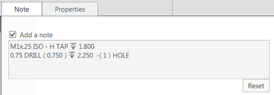

In Creo 4, there is this "reset" button in the Note tab to update the callout
However, your .hol file only has the single, default CALLOUT_FORMAT specified, so nothing will change in the annotation if you change a hole type (e.g. make it countersunk...)
If you wish to have a different annotation depending on the hole type, then you have to specify the table:
DEFAULT_CALLOUT_FORMAT_DATA in your .hol file.
It baffles me to this day as to why PTC doesn't provide nicely formatted .hol tables, but this has been a pain that many have gone through so it is well documented (google search for DEFAULT_CALLOUT_FORMAT_DATA)

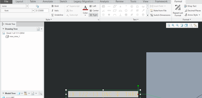

CB_10314989
(To:pausob)
I'm a little confused about where this note tab is. Off the annotation in the part, Choosing properties or edit value in the rclick menu gives me this:
and the format tab isn't giving me anything either
how can I find this note tab?
pausob
(To:CB_10314989)
The hole note tab is only active during the creation / edit definition of standard holes.
