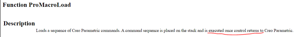

When developing the dialog function in Creo Toolkit, click the button, call the ProMacroLoad function, load the macro command, "~ Command `ProCmdEnvAnnotElemDisp` 1" to realize the display annotation function, but after the function is executed, the dialog box will be automatically closed. Is there any way to keep the dialog interface from being closed?

You should try a simple experiment - start 'Find' dialog (CTRL+F) and call your mapkey. Most likely, the active dialog box would close...
Generally, if you are calling mapkeys as dialog actions you would be better off to use asynchronous mode for pro/toolkit app.
