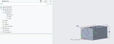

In the part environment, is it required to have the TOOLKIT-for-3D_Drawings ( advanced license - 222) to access and modify the annotations?
Upon using the ListItems(pfcITEM_ANNOTATION_ELEM) function of the C++ toolkit. I am getting an exception for not having the license.
Is there any other way to access it or the license is mandatory for this operation ?

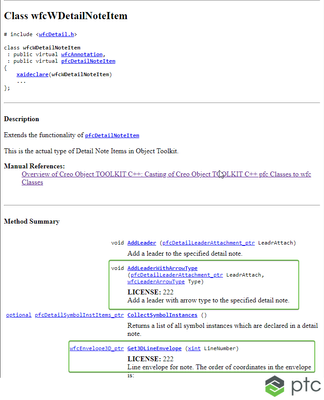

Generally speaking accessing 3D annotations and MBD at large is under license -222. This can come as a surprise and yet the information is delivered in the documentation.
For example:
To ensure your request is addressed can share a screencapture of the exception thrown?

This is the exception that I have obtained.
remy
(To:AP_10354419)
Thank you for clarifying the exception.
This indeed means that the method needs the license. It is mandatory.
