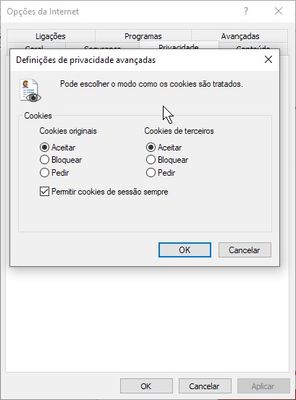

Anyone have this problem? How can iI enable cookies from
Thank you in advance

Open the same web address in stand alone Internet Explorer and enable the cookies there.

In Internet Explorer, Tools, Internet Options, Privacy, Advanced, 1st Accept, 3rd Accept, and check Always allow....

This tools are like you said and i still can not open.

Do you have to access the PARTcomunity outside of Creo? I accepted the cookies in stand alone IE and went back to Creo but still get the error.
Yes, I easily access the PART community outside of creo.
Just in Creo is that i have this error/issue.
In Creo 4 M130 (last release) this issues is solved.

The solution is to set windows_browser_type ie_browser on config.pro.
