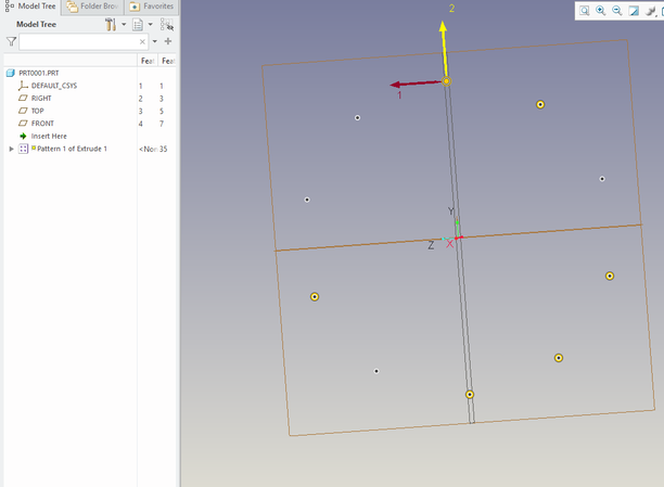

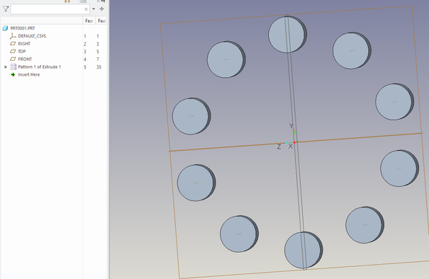

For example, I have the pattern created using Java OTK and FET:
Since I created this element using FET, I know that it has a certain structure, the elements of which perform certain functions.
But I could not find the element that is responsible for the functionality I need.

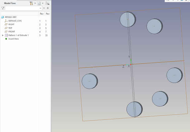

This is what I need:
1) disabling pattern elements.
2) the result that I need:
That is, I need to programmatically disable some of the pattern elements.
Thanks in advance!
Regards!

You may  try and extract the tree information and compare the pattern with versus without the excluded member.
VladiSlav
(To:remy)
Thanks for the advice!
I extracted the template tree in the XML-file with excluded members and without excluded.
And compared these two files.
It turned out that they are the same.
So FET cannot handle member exclusion, which means OTK Java too?
remy
(To:VladiSlav)
Thank you for performing the tests.
This is exactly what i would have done.
This test shows that JOTK and broadling speaking FET do not handle membership in feature pattern.
You may file an enhancement request on the Technical Support page.
