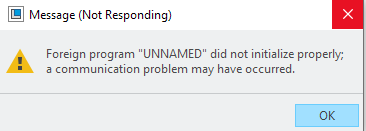

How to Handel "foreign program 'unnamed' did not initialized properly" popup?
VV_9675323
8-Gravel
I am creating Asynchronous  toolkit but i am getting this popup and after it my application stop working how i handle this
3 REPLIES 3
hi, having the same problem after updating a VB API Programm from Creo 3.0 to 8.0 (without changing code). Anybody got a solution?
Read this article - "Asynchronous Pro/Toolkit customization cannot connect to the Pro/Engineer process on windows 2008 server when "Service for Network File System" is installed": https://www.ptc.com/en/support/article/CS29167
thanks, but if Creo 3 works and Creo8 not can this be this problem?
